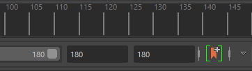

The animation sequence occurs over a 180 frame period. Before you begin to set keyframes you set the playback range in the Time Slider.
To set the playback range in the Time Slider
