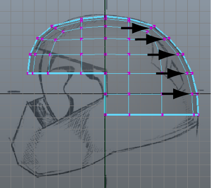

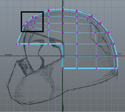

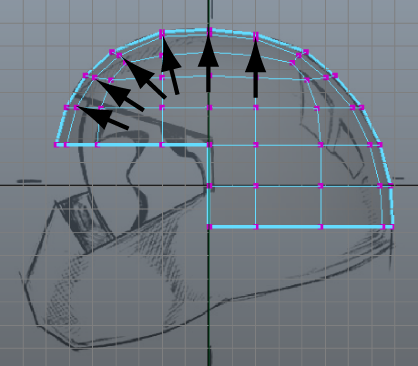

To manually reposition the vertices on the rear of the helmet
By moving the vertex as well as the vertex adjacent to it along the axis of symmetry, you ensure that the symmetrical shape of the helmet is maintained. If you move one vertex independently of the other it may result in an unwanted bump or valley in the mesh. These types of anomalies will become more apparent when you copy the completed half of the mesh across the axis of symmetry.
When you have finished, the back region of the helmet should closely match the reference image on your image plane.

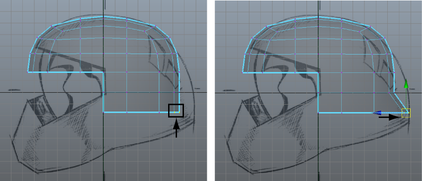

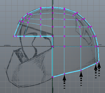

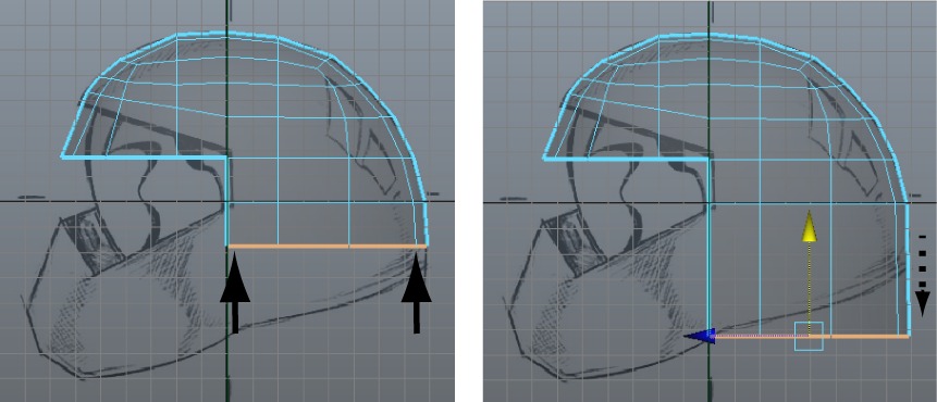

Next, you’ll reposition the border edges that lie along the bottom edge of the mesh.
To reposition the lower border edges on the helmet

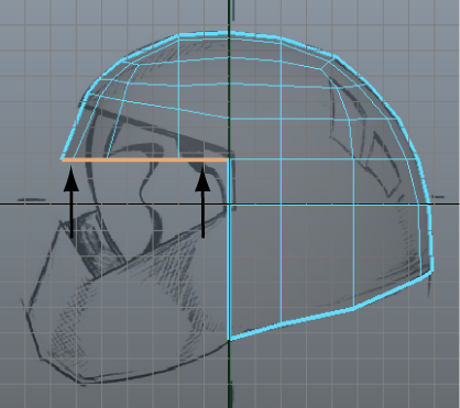

Up to this point in the lesson, you’ve been instructed to reposition the vertices on the helmet mesh only within the side view (Y, Z plane). Once you achieve the shape you want in the side view you will then concentrate on how the model appears when viewed from the front and perspective views.

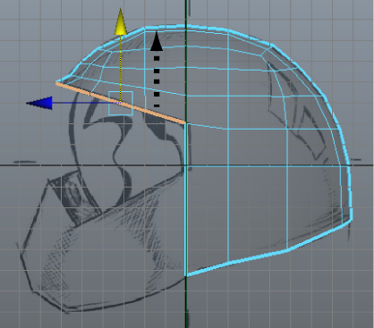

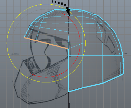

To edit the border edges on the upper edge of the face shield
The border edges in between are selected.

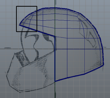

At this point in the lesson, the outline of your helmet should roughly match the helmet in the side view reference image. If it doesn’t, review the earlier steps in this lesson and make any adjustments to your polygonal mesh as required.

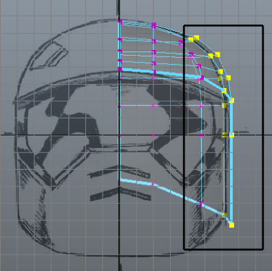

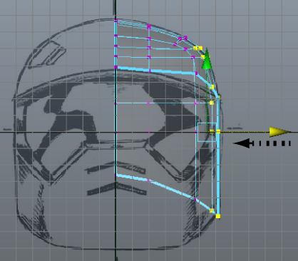

If you view your helmet in the front orthographic view, you’ll notice that the helmet shows a wider profile from this view than the reference sketch. In the next steps you’ll correct this using the front and top orthographic views of the helmet for reference.
To reposition vertices on the side of the helmet to match the sketch

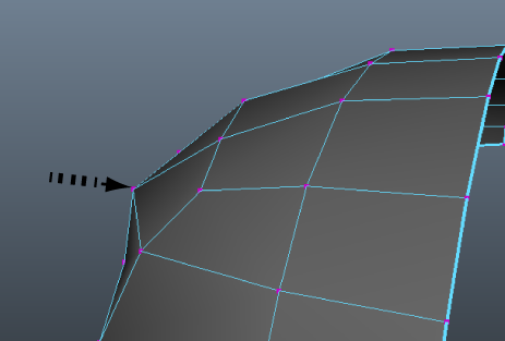

As you examine the vertices along any particular edge loop, the vertices on the mesh should appear to cascade in a smooth gradual fashion to create the curvature of the mesh with no undesirable spikes or dips.
