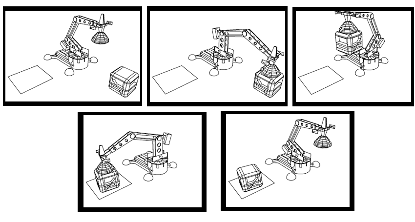

Now that the mechanical arm and cargo box are fully set up for animation it’s a simple matter to pose the arm and set keyframes. Prior to setting any keyframes you should take a few moments to plan the action for the scene.
Planning the action usually involves sketching a simple storyboard, and writing out a brief timeline for the action for each component. In this lesson we’ve provided a simple version for you. The basic premise for the action is as follows:
The table below breaks down the action indicating what action occurs for each object at the specified keyframes.
