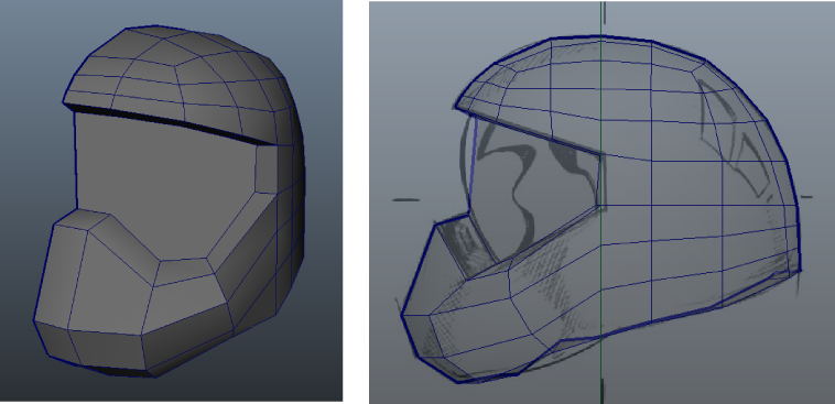

For the protective face shield on the helmet, you'll create one large multi-sided polygon using the Append to Polygon Tool and then split it into multiple four-sided polygons (quads) so that the new polygons match the existing four-sided topology of the helmet mesh.

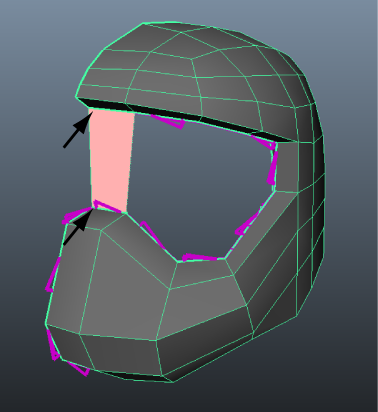

To create the face shield using the Append to Polygon Tool
If the planar option is on, the Append to Polygon Tool will not create a multi-sided polygon as the edges you’ll select do not form a planar region.
A polygon appears that spans the two edges.

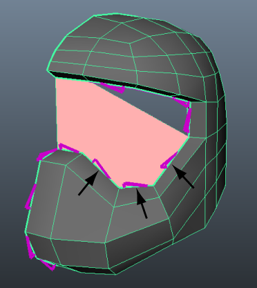

The multi-sided polygon is completed and added to the existing mesh. Multi-sided polygons are also referred to as n-gons.
Ideally, all faces should be four-sided to match the other faces on the helmet mesh. In the next section, you'll split the n-gon vertically and horizontally into several smaller four-sided polygons using the Split Polygon Tool.
