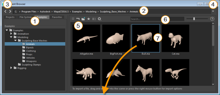

Content Browser, you can navigate through folders in different locations, search for files in the Content panel, and then import those files.
Navigating the folders
Expand the folder structure in the browsing panel on the left and select a folder to display its contents in the Content panel on the right.

1: Tabs in the browsing panel

2: Path bar
Select or enter an absolute path to find content:
- Click a folder name in the path bar to open that folder directly.
- Enter an absolute path name in the path bar to open that folder. This can be path to a folder that is local or on a network.
3: Back/forward arrows
Navigate among the previous and next locations you have already visited.
4: Navigation arrow
Open a menu that displays the recent navigation history. Select a location to go to it.
5: Go Up One Directory Level icon
Click the
icon in the Content panel to open the directory above the current folder and display its content in the Content panel.
6: Search field
Search the contents that are currently displayed in the Content panel - see below for details.
7: File
Import a file into your scene in different ways, such as by dragging and dropping it into a view panel.
