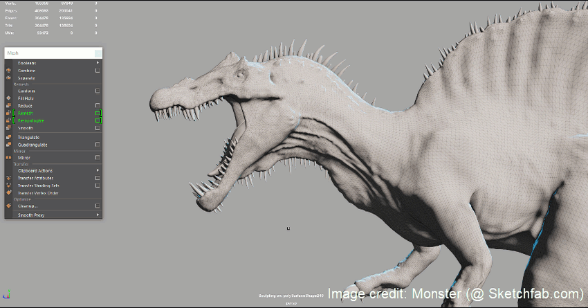

Polygon Remesh and Retopologize
Two new commands in the Mesh menu make it easy to fix or add topology to a selected mesh. Simply select components or an entire mesh and run a Remesh to add detail and evenly distribute edges over its surface, then run Retopologize on the surface to turn all its faces into quads. This can save you hours or even potentially days of painstaking manual modeling clean up. For more information, see Automatically retopologize a mesh.

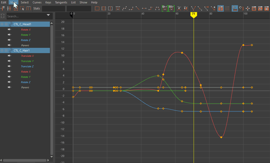

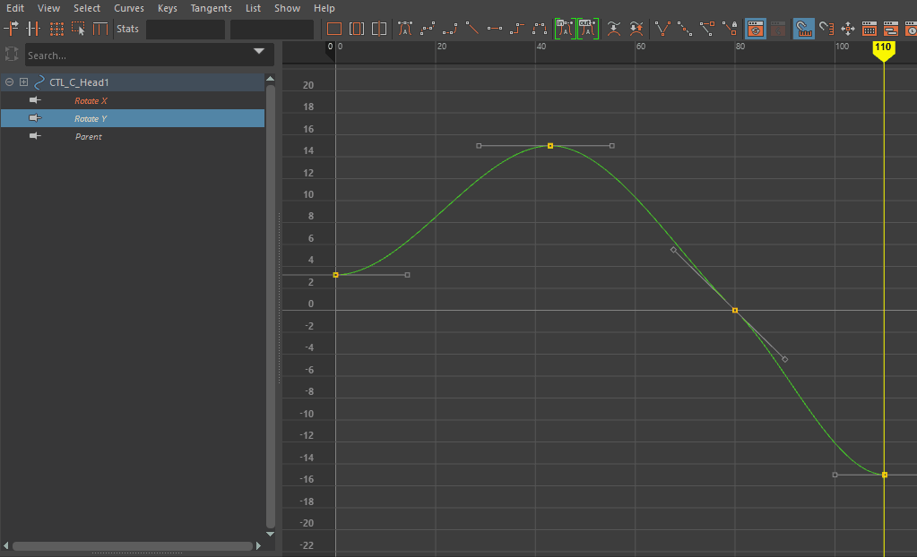

Graph Editor improvements
Tons of updates to the Graph Editor make it more customizable and intuitive in Maya 2020.
A new setting in the Time Slider Preferences, Loop play range when stepping frames and keys, lets you loop the Playback range instead of continuing through the entire animation. See Time Slider Preferences Loop play range when stepping frames and keys for more.

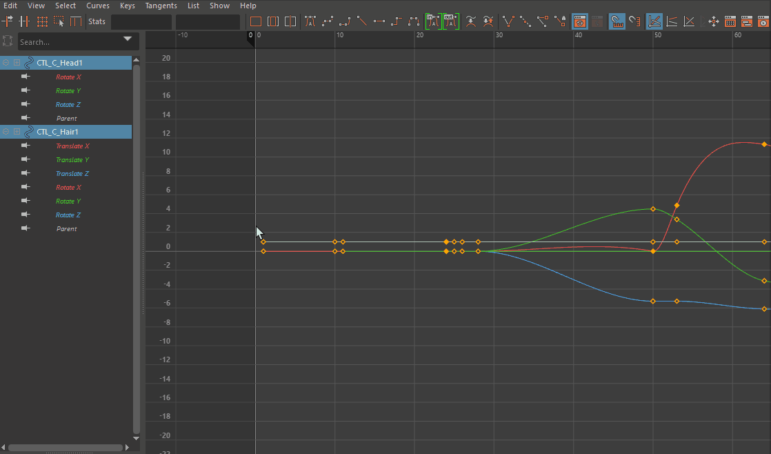

New Insert Keys option
A new Preserve Tangent type option has been added to the Insert Key options in the Graph Editor. To open it, select Keys > Insert Keys Tool > in the Graph Editor Keys menu.
Use this setting so that inserted keys recognize any in and out tangents that are already there, and inserting keys changes the shape of the curve to accommodate the tangent types on either side of the new key.
By default, when using the Insert Keys tool (hotkey: Alt + i), new keys are created with 'fixed' tangents, and neighboring keys are fixed as well to respect the shape of the curve. The Preserve Tangent type option overrides this, and the tangent type of the new key respects the current in and out tangents and affects the shape of the curve. With the new setting, when you insert a key with auto as the tangent type, the tangents of the keys on either side are unchanged. This makes the Insert Key behavior the same as setting a key (hotkey: s).

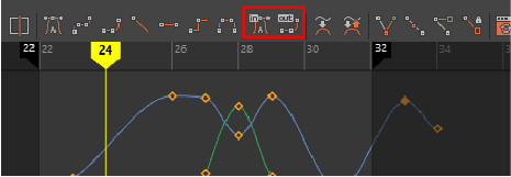

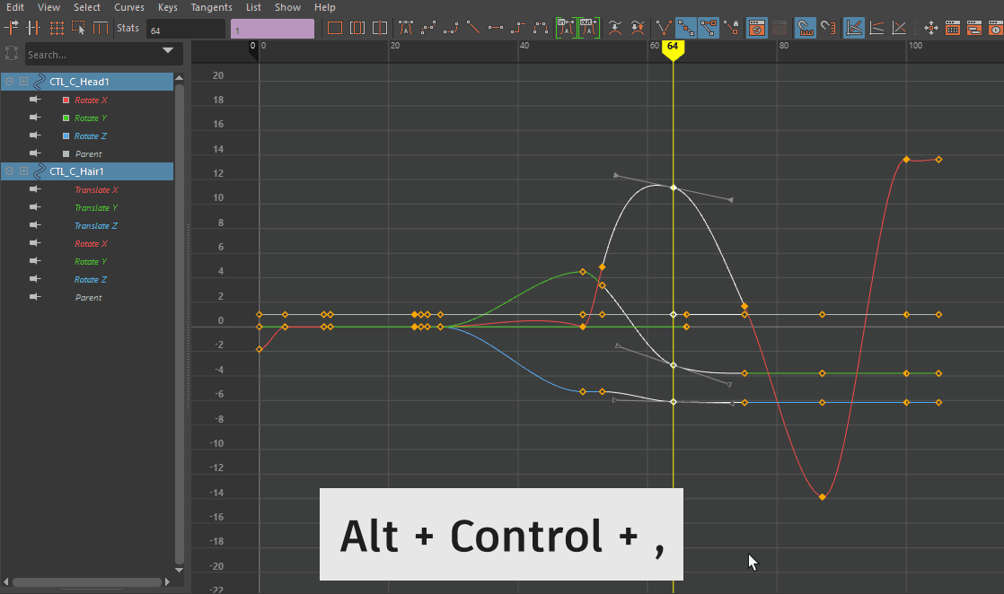

Graph Editor: Select previous and next key hotkeys
These new hotkeys let you scrub keyframe by keyframe, moving the selection to the left or right on the curve in the Graph Editor Graph View. Press Ctrl + Alt + , (comma) to move the selection to the previous key and Ctrl + Alt + . (period) to move the selection to the next key.

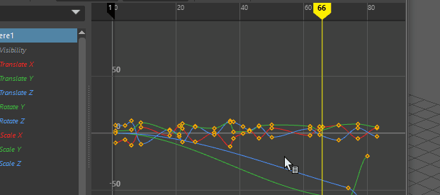

Modern Graph Editor Muted keys
The appearance of muted keys have been redesigned in the Modern Graph editor to better represent the fact that you can still edit curves while they are muted. This issue particularly affected Mac users.
Muted curves now resemble those in the Classic Graph Editor, appearing dimmer and muted keys now resemble regular keys.

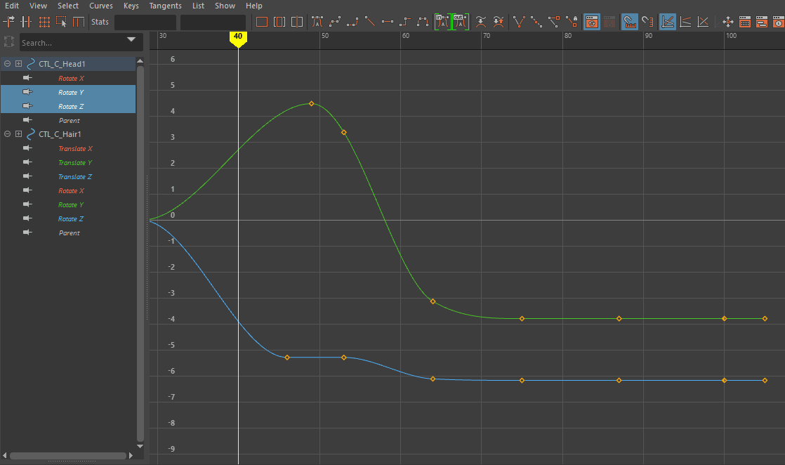

Modern Graph Editor key and tangent visibility
A new option, Highlight Affected Curves has been added to the Modern Graph Editor View Menu to highlight the segments of curve affected by the selected key/tangent, similar to Classic Graph Editor selected key/tangent behavior. This will aid visibility, especially in scenes with dense animation.

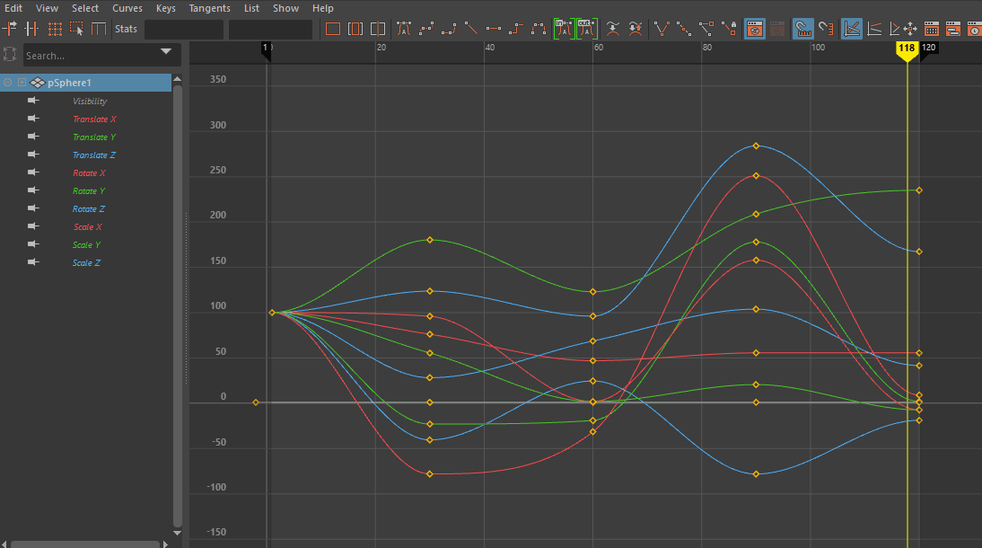

Resizeable Keys
A new setting, Key Size, has been added to the Animation (Settings) Preferences so you can customize the size of the keys shown in the Graph Editor Graph view.

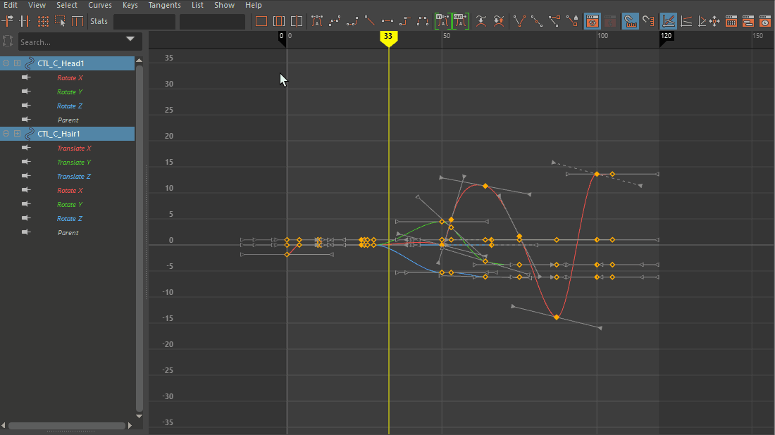

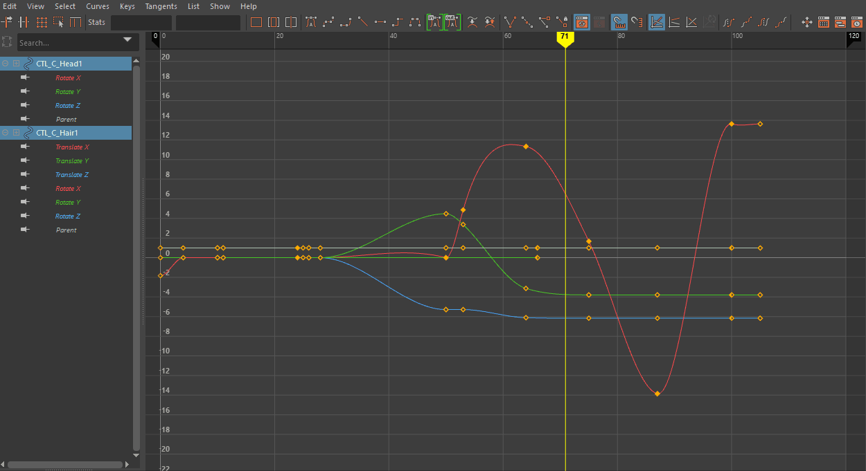

Simplified Key View
A new feature, Key View, lets you switch between the default Detailed Key and new Simplified Key View, similar to the Classic Graph Editor display, has been added to the Modern Graph Editor to simplify the key and tangent view. This is useful when you are working with curves that have a large amount of data.
Switch between views in the Graph Editor View menu, under Key View.

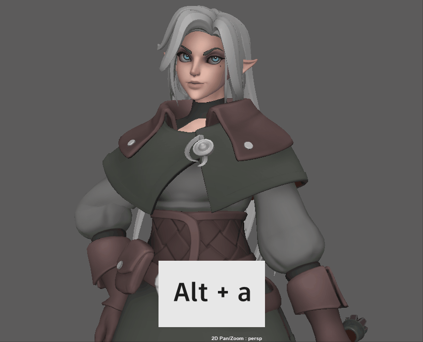

MotionBuilder-style X-ray toggle
Maya has borrowed Autodesk MotionBuilder's very useful hotkey toggle to switch between X-ray modes.
Press Alt + A to cycle through different X-ray modes
Cycle rig display mode is a shortcut that lets you press Alt + A to cycle between joints, controls, and character using the Cycle rig display mode hotkey. (You can also access these modes through the Shading Panel menu.)
