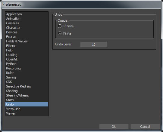

Undo preferences
In the Preferences window, the Undo preference settings let you specify the number of “undos” used by MotionBuilder.
To access the Undo preferences:
  1. From the menu bar, select Settings > Preferences.
  2. In the Preferences window, click the Undo preference option.
    The Undo preference settings display.
The Undo Queue lets you select an Infinite or Finite set of undos. If you select a Finite queue, you may want to reduce the Undo Level to save memory and speed up MotionBuilder. The default Finite undo value is 10.
