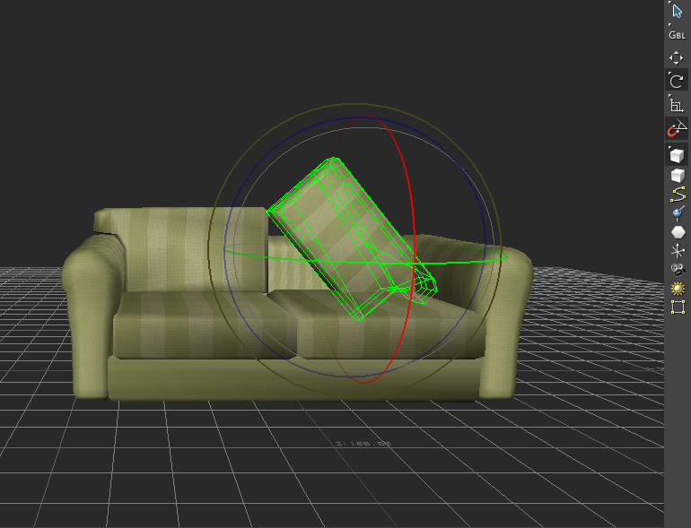

To rotate an object:
- Activate Rotation mode by clicking this icon
from the
Viewer window Manipulation and Transformation mode tools in the Viewer window.
- Expand the Rotate menu from the Viewer window Transformation buttons and select a Rotation mode from the Rotate options.

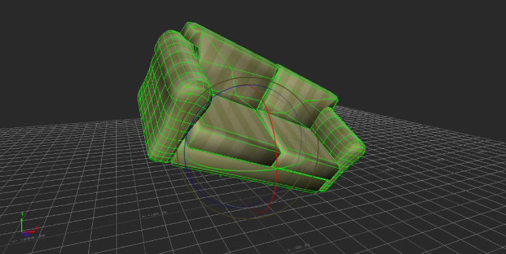

- Select the object’s rotation rings in the Viewer window and drag them or do one of the following:
- Enter precise values in Properties windows
Double-click a rotation ring and enter a value in the
Axis Rotation Degree Delta dialog box that appears.
Selected object in the Viewer window displays with Rotation rings for rotating on the X, Y, or Z axis

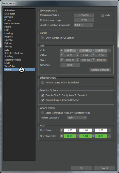

To snap the rotation of objects at specific increments:
- Select Settings > Preferences from the menu bar.
- In the Preferences window, select the Viewer preferences (A).
Preferences window
A. Viewer preferences
- In the 3D Manipulators area, enter the size of increment (in degrees) in the Rotation snap angle field.
