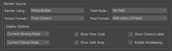

Use the Picture Format menu to select the resolution of the image to be rendered.
Render Source and Display Options
Changing the image size also changes the size of the preview window. MotionBuilder supports many resolutions from D1 NTSC (720 x 486) to full screen (1280 x 1024).
You can also set the image format by selecting the From Camera option and configuring the Current Camera’s settings. See Camera settings for more information on configuring camera settings.
Use the Pixel Format menu to select the color depth of your image. Selecting the color depth may change the Hardware acceleration shown in the Render window Statistics section. MotionBuilder supports standard color depths.
The Display Options include options concerning what information you want to appear on the rendered take.
Select the appropriate render type from the Display Options menu. The following options let you choose what is visible in the final render.
| Option | Description |
| Current Viewing Mode | Select Current Viewing Mode to make the final render show whatever is currently shown in the Viewer window, including skeletons, markers, selected items and so on. |
| Normal | Select Normal to make the final render with only the model, without skeletons or markers. |
| Models Only | Activate Models Only to hide all markers, Nulls, skeletons, cameras, and other objects that are related to the MotionBuilder interface. |
| X-Ray | Select X-Ray to have the final render show everything that is shown in the Viewer window’s X-Ray mode. |
The Stereo Display menu options enable you to select a Stereo Display mode before you render your scene. You must be looking through the Stereo camera in your scene for your selection to appear in the final render.
Render Display options mode
Choose from the following Stereo modes:
| Center Eye | Look through the center stereo camera. |
| Left Eye | Look through the left stereo camera. |
| Right Eye | Look through the right stereo camera. |
| Active | Use your graphics card for stereo viewing. If you are using the NVidia Quadro line graphics cards, and you have turned on stereo mode, the Active menu item becomes live. The CRT monitor uses the page flipping method of stereo imaging. The settings that you have chosen for your stereo mode in your graphics card are respected; for example, the DIN connector will send signal to your 3D glasses.
Note: Active mode requires a monitor with a refresh rate of 120 Hz.
| Horizontal Interlace | This viewing mode interlaces one row of pixels from the left camera with one row of pixels from the right camera and so forth. You obtain half the vertical resolution through this mode. Select this mode for polarized LCD monitors. |
| Checkerboard | This viewing mode alternates between one pixel from the left camera with one pixel from the right camera, forming a checkerboard pattern. You obtain half the vertical resolution and half the horizontal resolution through this mode. Select this mode for Samsung DLP 3D displays. |
| Anaglyph | MotionBuilder supports the red/cyan anaglyph mode. MotionBuilder composites the color output from the left camera with the color output from the right camera. |
| Luminance Anaglyph | The Luminance Anaglyph mode is similar to the Anaglyph mode, but the color output from the left and right cameras are first converted to grayscale before being composited on top of each other. |
| Freeview Parallel | Select this mode to see the left and right camera output side by side in the same window. |
| Freeview Crossed | This mode is similar to Freeview (Parallel), but the left camera output is displayed on the right while the right camera output is displayed on the left. |
| Current Stereo Mode | This mode makes your current selection in the Viewer > Display >Stereo Display menu active. |
Activate Show Time Code to have the timecode appear on the rendered take.
Activate Show Safe Area to have the Safe areas display in the rendered take.
Activate Show Camera Label to have the Camera label (the white text in the bottom left corner of the Viewer window) display in the rendered take.
Activate Enable Antialiasing to add a slight blur when rendering. See Using Anti-aliasing with cameras for more information.
Pixel Format, Antialiasing, Show Time Code and Safe Area are not available when rendering .swf files.

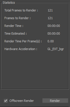

The Render window Statistics display the render status as your scene is being rendered. The Statistics area displays the render status while your scene plays in the Render window.
The Render window settings include the rendering Statistics and the option to enable or disable Offscreen Render.
Render Statistics pane
The Statistics area is only provided as a reference. You can modify the Statistics fields using the options in the Render Settings pane.
| Field | Description |
| Total Frames to Render | Gives the total number of frames between the Start and Stop times. |
| Frames to Render | While rendering, acts as a counter showing how many frames remain to render. |
| Render Time | Indicates the elapsed rendering time, measured in seconds. |
| Time Estimated | Estimates the amount of time remaining to render the rest of your take. |
| Render Time Per Frame(s) | Shows the amount of time it takes to render each frame. |
| Hardware Acceleration | Displays the hardware accelerator used to render. The accelerator shown depends on your computer system. |
Click Offscreen Render to render your scene to the selected Output File, using the selected Output Format.
Depending on what type of Output Format you have selected in the Render Settings pane, additional dialog boxes may appear first to let you define other settings. For example, when you select AVI as the Output Format, the Video Compression dialog box appears.
Refer to the descriptions of each format under the Render File Output section for more information on the additional dialog boxes.
