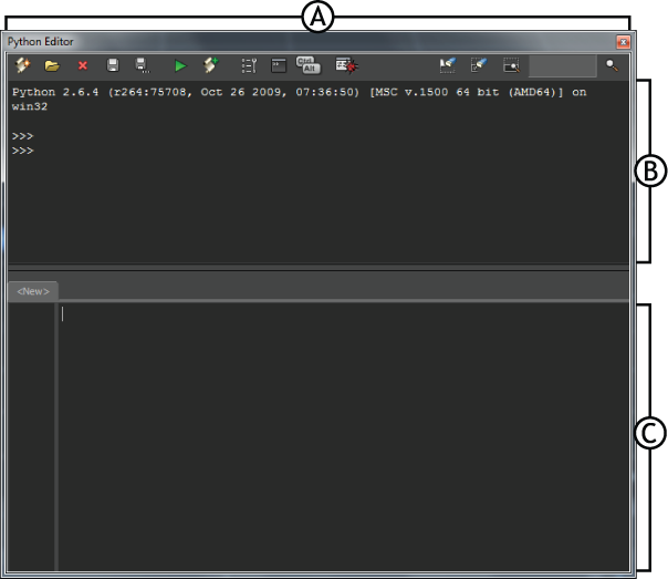

The Python Editor tool consists of the following areas: the toolbar, the interactive console, and the work area.
Python Editor: A. Toolbar B. Interactive console C. Work area
You can resize the Python Editor window by dragging any corner or border of the window.
