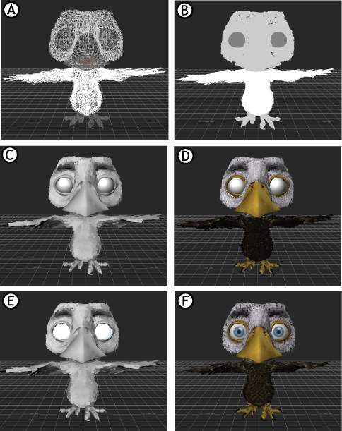

The Models Display menu option contains global shading options that apply to the entire scene.
Models Display options A. Wireframe B. Flat C. Lighted D. Shaded E. Textured F. Shaded & Textured
The Models Display menu options are:
Models Display option |
Description |
Wireframe |
Displays selected objects as wireframe. |
Flat |
Displays selected objects using a constant color. This option ignores light sources in a scene, and overrides any custom shading, textures, and materials applied using the Shader settings. See About shaders. |
Lighted |
Displays selected objects using their custom shaders created in the Shader settings. Textures do not display. |
Textures |
Displays selected objects with their applied textures. This option is available only when the Lighted option is selected, in which case Use Textures is active by default. See Textures. |
Shaders |
Displays selected objects using the default shader. This option is available only when the Lighted option is selected, in which case Use Shaders is active by default. |
Textures + Shaders |
Displays selected objects with both the default shader and their applied textures. |
