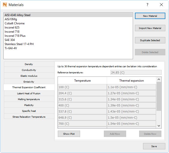

Click to manage the materials in the library. Users can create new materials, delete unwanted ones, and duplicate a material as a basis for defining a new one.

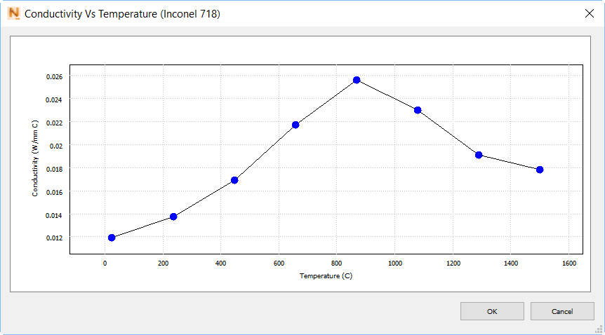

Sample plot of thermal conductivity for Inconel 718
When creating a new material, first specify the name, and then the various physical properties in the chosen system of units. To change the system of units shown here, go to the
, and open the
Units drop-down menu.

Show Plot button is available for temperature-dependent properties, to plot values displayed in the table.

There are three ways to do this: duplicate an existing material, import a material property file, or click the New Material button and manually enter the name and properties.
To duplicate a material and modify properties
- Select a material with properties similar to what you want in a new material, and click
Duplicate Selected. The material name is appended with ' - copy' to differentiate it from the original.
- Optionally, change the default name by double-clicking it and entering a new name.
- Modify the material properties as required. Note that properties having a table of values include
Add Row and
Delete Row buttons to facilitate modifications.

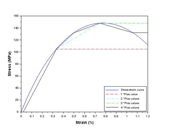

- Plasticity - Up to 10 pairs of stress-strain points can be used to describe the plasticity curve of the material at each temperature. Perfect plasticity is assumed after the final plasticity point at each temperature. Every temperature must use the same number of points. To enter the plasticity curve, specify the temperature, stress, and strain. Points with the same temperature will describe the yielding behavior at that temperature. For example using 3 points to describe the yielding behavior of a metal would look like this:
Different approaches for approximating the plasticity curve are shown in the figure below:
Using more points allows for a closer approximation of real material behavior, but can increased the computational time during moving source simulations, PRM generation, and models that enable
