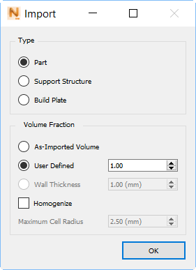

Follow the step-by-step instructions shown in the video. Sample files for use with the tutorials are available on the Download Page.
You will open three more files from this folder.

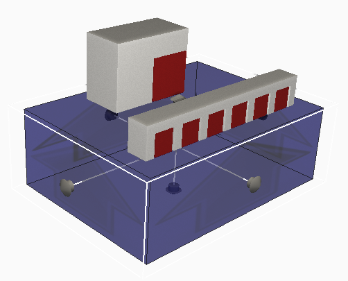

The build plate expands to accommodate both parts.
and expand the build plate in X and Y directions to be a bit wider than the parts. You can use the handles shown in the figure, or change the
Length values for X and Y on the Size tab.

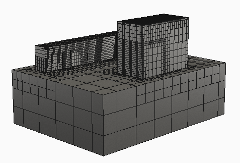

Note how the size of the mesh elements varies by location. This shows the adaptive meshing strategy, which decreases the number of degrees of freedom required to solve the problem.

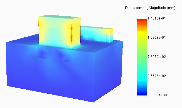

Note the high values for recoater clearance (highlighted), indicating that the support structures were keeping distortion to low levels. The default value for Recoater Tolerance is 80%. Recoater Tolerance is a user-defined value, set in the Solver Settings dialog, which specifies how much risk is accepted when predicting possible recoater interference. The lower the value, the higher the threshold is for issuing a recoater warning. Higher values will issue more recoater warnings. Consult the Recoater Tolerance page for further information.

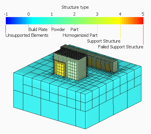

Here you can see that the build plate, parts, and support structures are clearly marked.

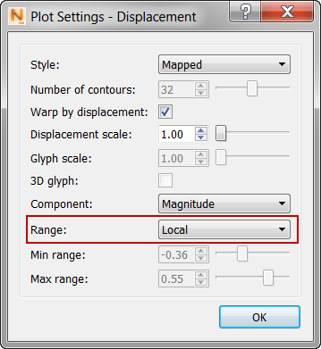

For a clearer display, as shown, you may want to right-click Displacement in the Browser, select Render Properties, and turn off Element Edges.
