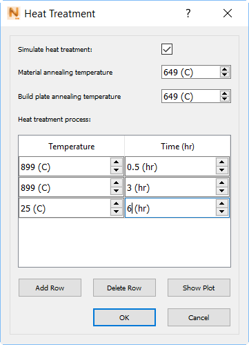

In Simulation Utility, users can add a heat treatment cycle to the end of a thermo-mechanical simulation to relieve stresses accumulated during manufacturing. This tutorial uses the material Inconel 625.
Sample files for use with the tutorials are available on the Download Page.
The time value for a particular temperature phase indicates the elapsed time from the beginning of heat treatment to the end of that temperature phase. The system will check that the times are a series of increasing values.

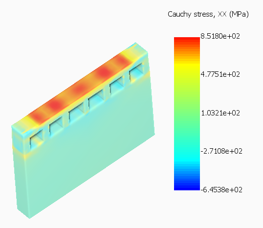

The Timeline and time stamp for these results indicates that we are seeing the stress results of the heat treatment process. Stress is at the maximum at the first increment of heat treatment (shown below), then gradually relaxes.
