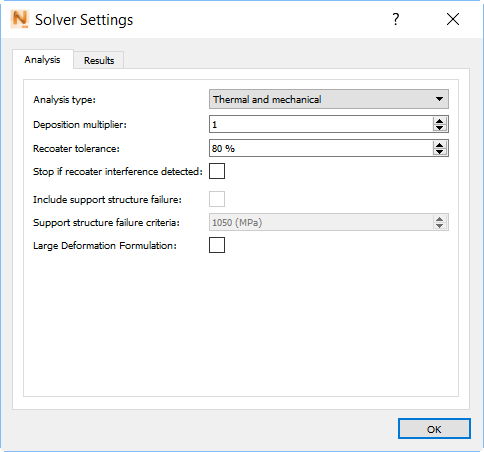

  3. Click Home tab > Solver Settings > Analysis tab.
    Note that Deposition multiplier has a default value of 1. This means that the simulation will account for only the part or parts on the build plate. We will first solve the simulation with this setting.
  4. Click OK and then Solve.

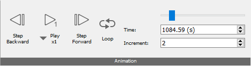

  5. When the results appear, on the Results tab, Animation panel, click the Step Forward arrow once to see the elapsed time for deposition of the first layer group: 1084.59 seconds in this case. This time can vary widely, depending on the computing power available.
  6. Go back to Home tab > Solver Settings > Analysis tab and change the Deposition multiplier setting to 4. The simulation will account for the building of 4 parts on the build plate, and extend the timeline accordingly.
  7. Click OK and Solve again.
  8. On the Results tab, Animation panel, click the Step Forward arrow once again, and you should see that the elapsed time is somewhat longer: 1218.65 seconds in this case.
