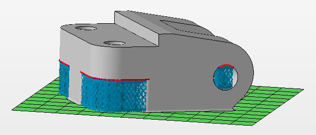

The lattice-like supports are created.
Click
Apply support.

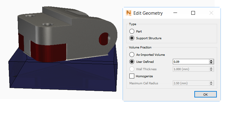

In the
Simulation Utility Browser, right-click on the support structure, which has a name that includes
_hulledsupport_, and select
Edit Geometry.
One benefit of using Netfabb to generate supports appears here, in that the
Volume Fraction is automatically calculated during support creation. Volume fraction is the amount of the support volume that is occupied by physical structures rather than empty space. Leave the existing value unchanged.

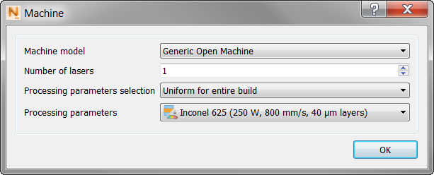

On the
Home tab, click
Machine to start setting up the simulation.
In the
Machine dialog, set
Machine Model to
Generic Open Machine and
Processing Parameters to
Inconel 625.

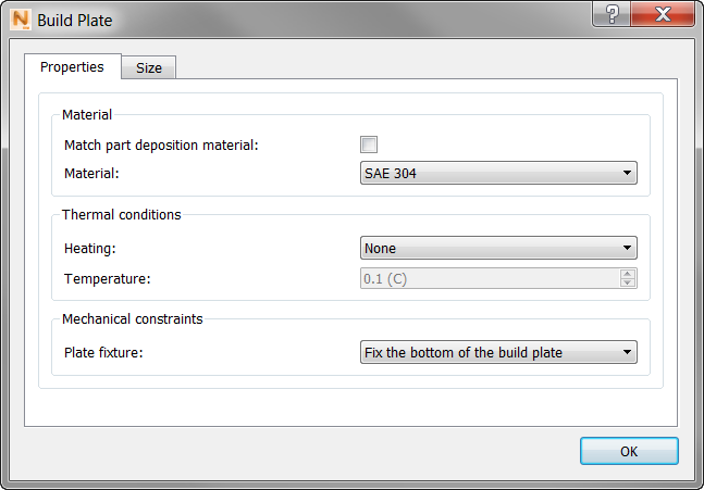

Click OK to close the Machine dialog, and click
Build Plate > Size tab, then click
Snap to X and Y.
In the Build Plate dialog, click the
Properties tab; here deselect
Match part deposition material and set
Material to
SAE 304.

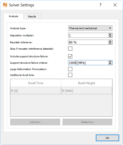

Solver Settings. On the
Analysis tab, select
Include support structure failure, and set the failure criteria to
1000 MPa.

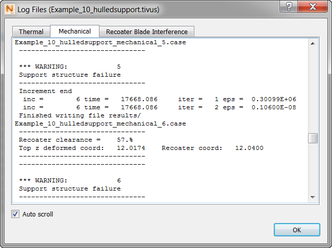

Click
Results tab > View Logs to read the solver output.
In the
Log Files window, click the
Mechanical tab, and scroll down, looking for Warnings.
You may see several warnings of support structure failure. These indicate that the
support structure failure criteria, specified in MPa units in the
Solver Settings, was exceeded during simulation.

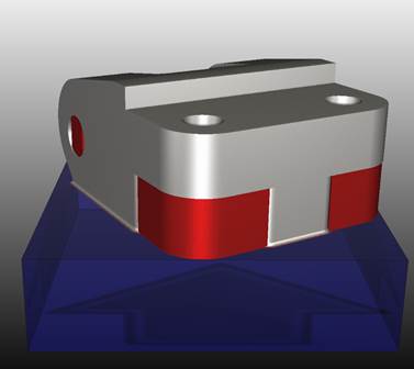

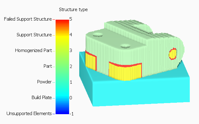

In the Browser
Results folder, use the light bulb icons to show the
Structure Type results. In the
Animation panel, move the increment slider to the right to view the last increment before build plate removal.
The
Structure type results are color coded into 7 different element types, and the failed support structures are clearly visible in red.

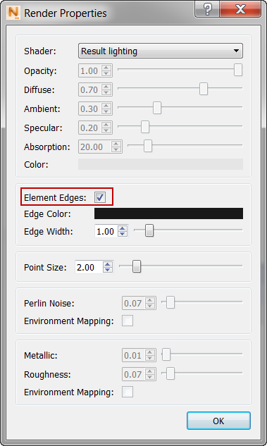

If you want to turn off the element edges display for a clearer view, as shown above, right-click in the Results Browser, select
Render Properties, and deselect
Element Edges.

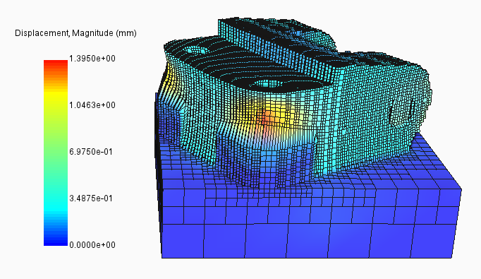

Use the light bulb icons to show the
Displacement results.

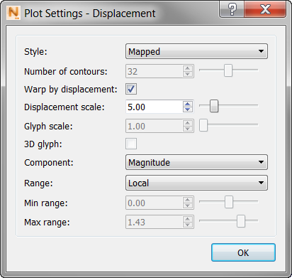

Click
Plot Settings.
Select
Warp by Displacement, and change the
Displacement Scale to
5.0 to exaggerate the displacement five times. Click
OK to exit the settings dialog.
For this example you may want to turn the element edges back on in the
Render Properties dialog. The warped displacement results with visible element edges should look similar to the figure below:
Note that the elements at the support-part interface look distended. Rotate the part and zoom into the distended region.
Observe the excessive displacement of the part at this location. You may want to go back to the
Mechanical log file and make note of one or more specific time increments when the warnings of support structure failure occurred. You can enter those times into the
