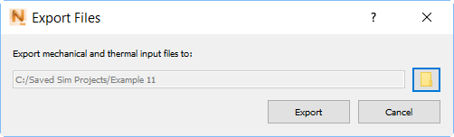

  6. Click Simulation menu > Export > Solver Input Files.
  7. In the Export Files dialog, click the Browse button, create a new folder in a good location and name it Example 11. Select this folder, and back in the Export Files dialog, click Export to save the input files.
    The Example 11 folder opens so that you can see the exported files.

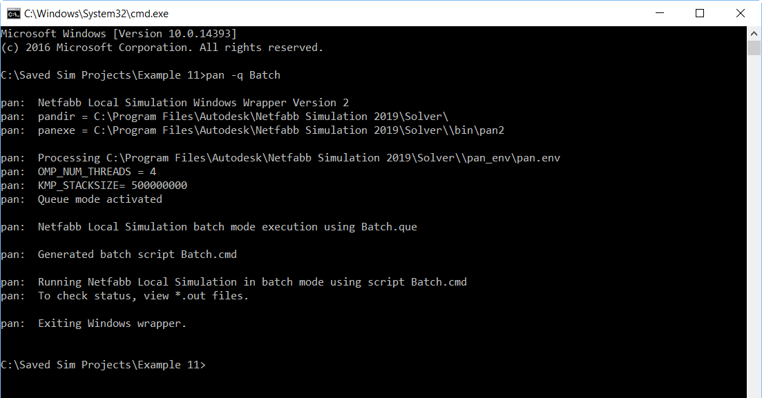

  15. To execute the batch command, type pan -q Batch from the command prompt, and then press Enter.
    pan is the solver executable, -q indicates a batch file will be used for the inputs, and Batch is the name of the .que file, without the file extension. The execution and output returned from the solver should look similar to the following (with updated product version numbers):
    The solver ran the four simulations in sequential order. In the Example 11 folder, you should see .out, .case, and other output files for each simulation.
