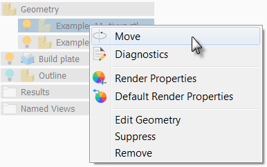

Open the Move dialog from the Browser by right-clicking the part you want to move, and clicking Move from the menu.

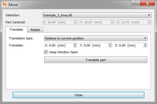

To do several Translate or Rotate actions without having to reopen the dialog after each one, select Keep Window Open in the Move dialog. If your actions move a part so that its base is no longer seated on the build plate, pressing Close moves the build plate to be in contact with the part.
To translate a part relative to current position
  1. Set Translation type to Relative to current position.
    Note that X, Y, and Z values are zeroed.
  2. Set X, Y, or Z distance values to specify how far to move the selected part.
    Positive values move the part away from the origin; negative values move it toward the origin.
  3. Click Translate part.
    The part moves the specified distance and direction.
To translate a part to an absolute position
  1. Set Translation type To absolute position.
    Note that X, Y, and Z values are set to the current location of the selected part.
  2. Change the X, Y, and Z values to the desired location of the part.
    Lower numeric values move the part toward the origin; higher values move it away from the origin.
    The part moves to the new location.

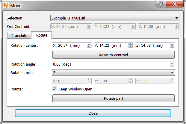

To rotate a part precisely on an axis
  1. Set the Rotation angle value in degrees.
  2. Set the Rotation axis to X, Y, or Z.
  3. Click Rotate part.
    The part snaps to the rotated position.
