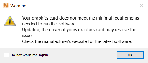

When you open a project or import a file, Simulation Utility checks the graphics card of the computer to determine if it is suitable for running the application. If the graphics card is not suitable, you will see the following warning:

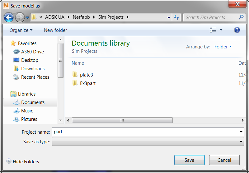

Before running a simulation, click here to save your part file with the .tivus extension, specifying the name and location.
By default, the name of the folder that contained the imported STL part appears in the Project name field, and will be the name of the project folder, unless you decide to change it here. If you use the Save As command, the folder will have a numeric suffix in the name (example: part1), and be created at the same level as the project folder, unless you decide to move it. The model file (part.tivus in this example) is created inside the folder. When you run a simulation, related files will also be created inside the project folder. If you do not want to run the simulation now, you can do it later by clicking and selecting the saved TIVUS file.
