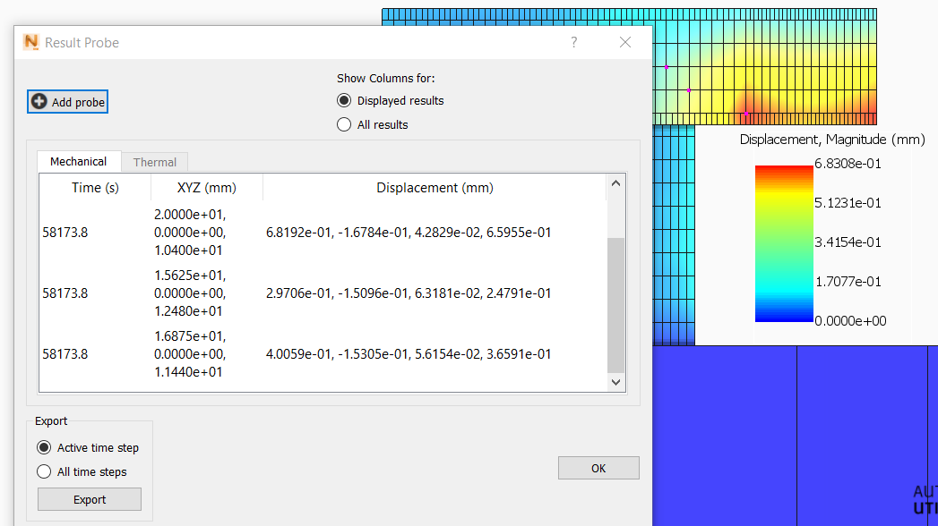

Click Table when you want to see the numeric values for selected points. The Result Probe table opens, as in the figure below, which shows only the Displayed results, Displacement in this case, for the three points selected in the figure, just to the right of the open dialog. If you select All results, the table expands to display all available results for each selected point. You can expand the dialog or scroll to see additional data columns.
If you know the coordinates of a point, click Add probe and enter the X, Y, and Z values. If the values you enter are outside the bounds of the part at the displayed increment, you will see a warning message about this.

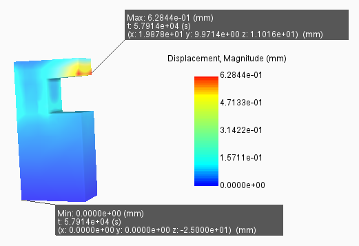

In the Selection panel, you can select the Maximum and Minimum check boxes to identify and label the points with maximum and minimum values of the displayed attribute. The figure below shows an example for displacement.
In the Result Probe dialog, you can use the Export controls to export the Result Probe table values in CSV format for use in spreadsheets, plots, and other forms of post-process analysis. Choose to export values for only the displayed increment (time step), or for the entire simulation.
