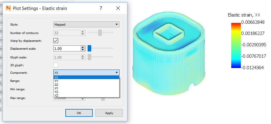

The default display for Elastic strain results is strain along the X axis (XX). In the Plot Settings dialog, you can change the Component setting to display strain along the Y axis (YY), Z axis (ZZ), or shear stress along two axes (XY, YZ, or XZ).
Available display styles include Mapped, IsoSurface, and Glyph.
If your simulation runs with Structural Plasticity turned on in the Solver Settings, Results tab, you see results for Plastic strain and Equivalent plastic strain. Plastic strain has the same display options as Elastic strain, but Equivalent plastic strain is more limited. It has no Component options, and display style is either Mapped or IsoSurface.
