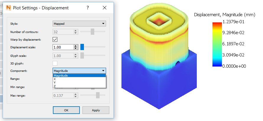

Displacement Results
The default displacement results show Magnitude, but in the Plot Settings dialog, you can change the Component setting to show displacement along a single axis: X, Y, or Z.
You can also select Warp by displacement, set a Displacement scale greater than 1.00 to exaggerate the displacement, and change the display style to IsoSurface or Vector.
