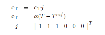

The thermal strain is computed as
Equations 12 through 14
where
α is the thermal expansion coefficient and T
ref is reference temperature.

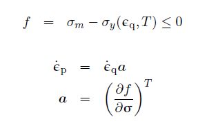

The plastic strain is computed by enforcing the von Mises yield criterion and the Prandtl-Reuss flow rule:
Equations 15 through 17
where
f is the yield function, σm is Mises' stress, σy yield stress, εq is the equivalent plastic strain, andα is the flow vector.
