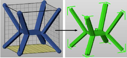

This gives you a three-dimensional preview of the cell and allows all part handling operations with the cell.

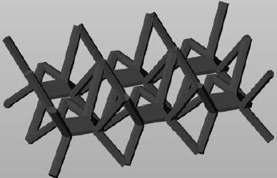

In the Information tab, you can add notes or descriptions about the cell. If the Use as Preview check box is enabled, the cell is used as a preview when you edit your volume data or click on the structure or Cells directory in the project tree. After you click on a structure or the Cells directory, you may adjust the Tile to determine how many cells are displayed along each axis. In doing so, you can see if your structure forms a coherent structure when inserted repeatedly. Only one cell can be used as a preview at the same time.
