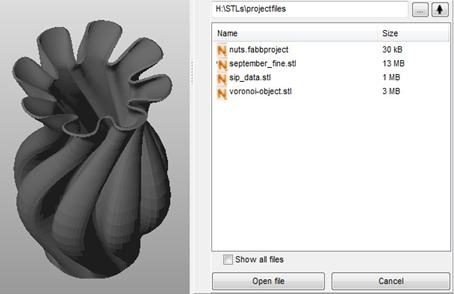

Use Netfabb to quickly preview suitable files in the file system without having to open them
Use the File Preview Browser to examine files before adding them to your project. This tool loads tessellated models and slice files.
The File Preview Browser opens in the context view.
Browse to navigate to and add a file to the browser.
The File Preview Browser supports three-dimensional files and 2.5-dimensional slice files, in various file formats.
