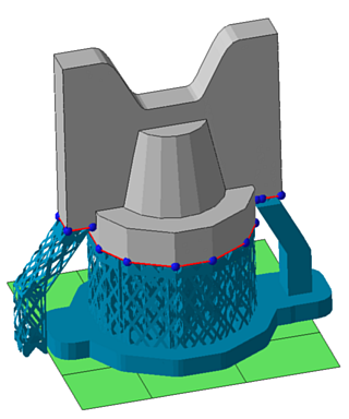

Base plate |
The base plate is a volume of configurable thickness that follows the shadow area of the part. In addition, it follows the contours of solid volume support structures as they touch the platform surface with a configurable margin. |
![]() A wingnut with a base plate. Note how the solid volume support (right) extends the baseplate circumference beyond what has been derived from the part's shadow area alone. |

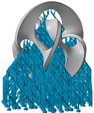

Adaptive Lattice Bars |
This action generates a regular volumetric scaffolding from lattice cells of interconnected bars. This makes very rigid bar support possible in areas that have undercuts themselves while mimizing part-to-part support. The bar density is also dependent on the individual support requirement: If there is enough free volume available, multiples of cells are recursively collapsed into singular larger cells. |
![]() The scaffolding of bars supports otherwise difficult-to-reach surfaces well. |
