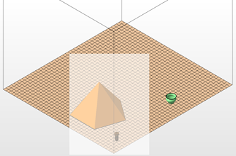

- Window: Click and drag a window on the display to select all parts within the window.
Select several parts at once with help of a window selection.
