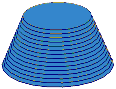

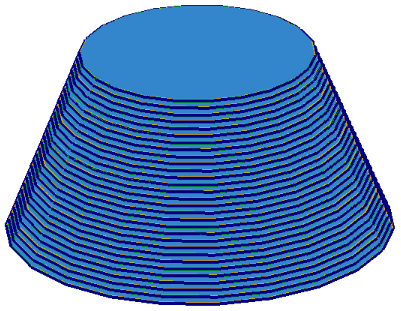

A Layer filter allows you to extract specific layers from a slice stack. This is a binary procedure, so each resulting layer is either empty or contains the same geometric information (contours and hatches) as the input.
| Parameter | Default Value | Description |
| minlayer | 0 | Determines the start layer index of the filter. Every layer below this index is discarded. |
| maxlayer | top layer | Determines the end layer index of the filter. Every layer above this index is discarded. |
| onlyeachlayer | 1 | Determines if only every n-th layer is used. |
| layeroffset | 0 | If the onlyeachlayer parameter is larger than 1, there is an ambiguity where the layer selection should start. A layer offset allows you to control the behavior. For example, use either each second layer or each second-plus-one-th layer. |
