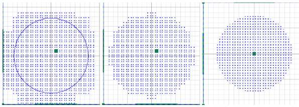

If the Cut Simulation check box is enabled for the structure, a Boolean operation is automatically conducted for the slice, creating a cross section of the part and the structure. That means that all grid cells standing outside of the original part are cut along the surface of the part, and only the sections of the structure which are within the part remain in the slice. To see this effect, enable the Preview Calculations check box in the tabsheet.
