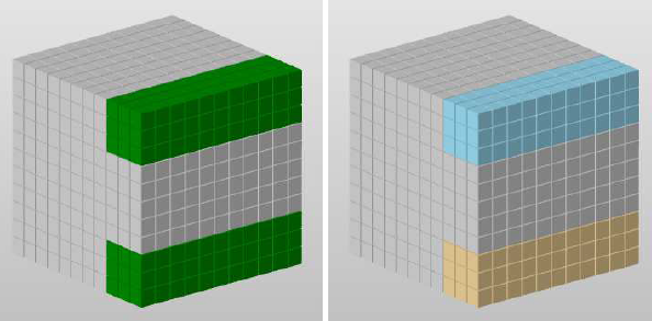

If you right-click on a fragment and choose Split into connected fragments, all selected fragments are split apart, so that only connected grid cells belong to the same fragment. If a fragment consists of two components, for example, and these two regions are not connected, they will both become individual fragments.

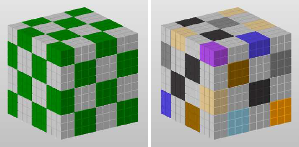

Click the Select Grid Cells icon
to select individual grid cells. Selected grid cells appear blue. Click the grid cell again to remove it from the selection. You can select grid cells from different fragments.
After selecting grid cells, right-click anywhere on the screen to edit the selected cells.
To unify fragments, simply select all fragments you want to merge, right-click on one of them and choose Merge. The fragments are combined into one fragment. It is possible to merge fragments in any position, even if they are not connected.

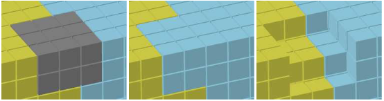

Right-click a fragment in the project tree and choose Delete Selected Fragments to remove the selection.
After you have removed a fragment, the grid cells previously occupied by that fragment are empty. This means that you cannot assign a structure cell to this area of the part nor produce it solidly. When you create a slice out of the structure, which subsequently will be prepared for production, the section of the deleted fragment will be empty.
