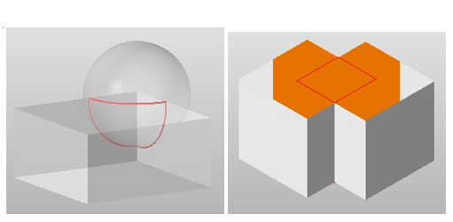

Triangles cutting through each other create conflicts for slicing and other processing steps
Self-intersections occur when triangles or surfaces of shells cut through each other. Once detected, self-intersections are highlighted with a red line. The line is visible even when the self-intersections occur inside or on the back side of the part. If surfaces lie on top of each other, all triangles associated with the double surface are colored orange.
Left: Cutting line of a self-intersection. Right: Triangles belonging to a double surface inside the part are marked in orange.
