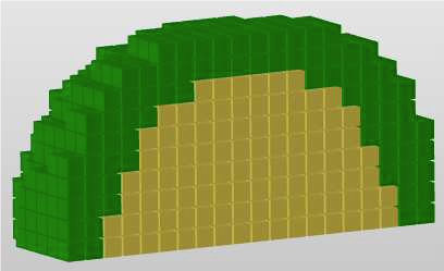

3S The solid part is gridded and fragmented with the 3S Executor. The fragments are groups of grid cells, or voxels, of the gridded part. The voxel resolution of the grid and the fragment sizes and arrangement can be defined differently for every structure. There are various ways to assign different sections of the part to different fragments. After the fragmentation, you can insert different structures or solid cells into the different fragments. The structure cells are multiplied within the fragments and are arranged together to form a connective structure. With this process, the structure is applied to the part.
