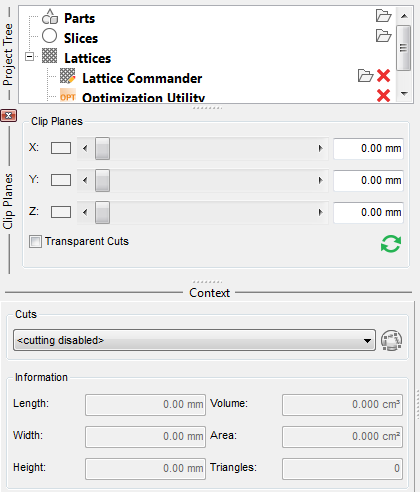

Rearrange or detach the views that make up Netfabb's window to suit your space and display preferences
Netfabb's user interface consists of several panes, or views, arranged in a window layout. The layout of the interface can be adjusted by resizing, repositioning, stacking, even detaching the different views that make up the interface. This can be especially useful on a multi-monitor workplace.
Select from default window layouts
Click Settings > Reset Window Layout and select from Default, Classic, and Center.
Adjust the window layout manually
  1. Click Settings > Unlock Views.
  2. Click and hold the header line that appears around the title of the desired frame and move the frame to the desired location.
  3. Resize the frame using the splitter handle as desired.
  4. Repeat steps 2 and 3 for the other frames until the layout is arranged as desired.
The layout is saved when you close Netfabb.
