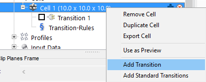

When a transition is added, it is included into the project tree as subordinate element of the cell. When a transition is selected in the project tree, the normal bars, faces, and STL-elements of the cell are displayed transparently in the display. Similarly, when the cell itself is selected, the elements of all enabled transitions are displayed transparently.
