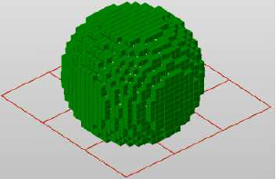

When one or more fragments are selected, you can change viewing options in the tabsheet:

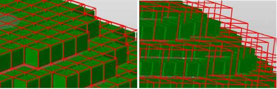

When structure cells are larger than grid cells, you can use the Translation to shift the structure cells by one grid cell in the direction of the three axis.

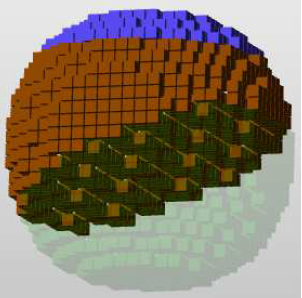

To view fragments with transparency:
This visualization option is indicated by a ghost icon in the project tree and enables you to see fragments in the core of parts without completely hiding the fragments in front of it. You can simultaneously see fragments in the foreground and in the background.
