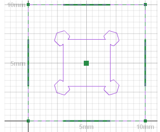

It is not necessary that all cells of the structure have the same size. However, it is recommended that cells are created which have a common denominator along all three axes, so that they can be arranged properly without overlapping. It is also recommended to use this denominator as the size for the grid cells in the Volume Data.
If the Enforce Cell Size check box is enabled, you cannot move elements out of the cell. If it is disabled, elements can be moved outwards and overlapping structure cells can be constructed. Whenever you enable or disable this check box, it is switched accordingly for all other tabs.

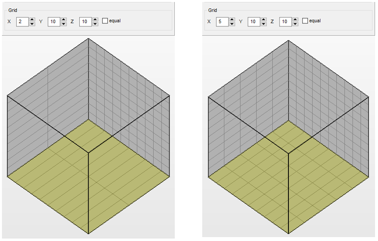

In the display, the cell walls are marked by a grid consisting of rectangular squares. The grid plays a vital role during the placing of elements in the cell, as some ways of placing elements refer to the grid lines, independently from lengths and distances.
At the bottom of the tab you can change the number of grid lines across the three axes. If the Equal checkbox is enabled, there will be an equal number of grids along all three axes. If it is disabled, the grid can be adjusted to a much finer factor along selective axes, or if the cell size is set differently along the three axes, the grid squares can be made quadratic again. The number of grid lines does not have any influence on the cell size.
