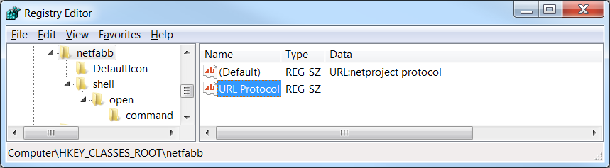

The Netfabb Protocol Handler is a project and an executable available upon request in conjunction with a licensed add-on privilege. The protocol must be registered manually by making modifications to the Windows Registry:
Furthermore, remote control needs to be allowed in the Settings .
