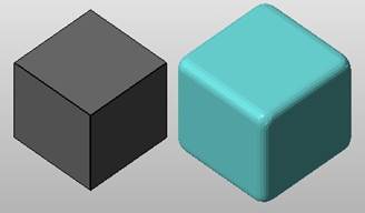

- Outer Offset: New part
thicker than the original as determined by the shell thickness.

Outer offset (right) of a box
