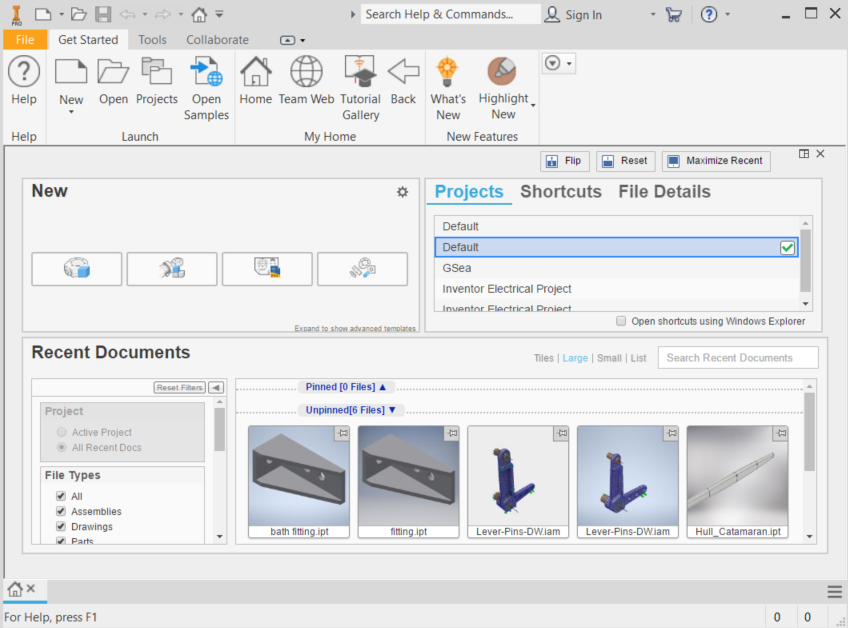

  1. Start Autodesk Inventor (Standard or Professional).
  2. In the Add-In Manager, make sure the Autodesk Inventor Nastran Add-in is checked (enabled) and set to start/load automatically.
  3. Create a New Inventor document, or Open an existing one, to start the licensing and activation process.

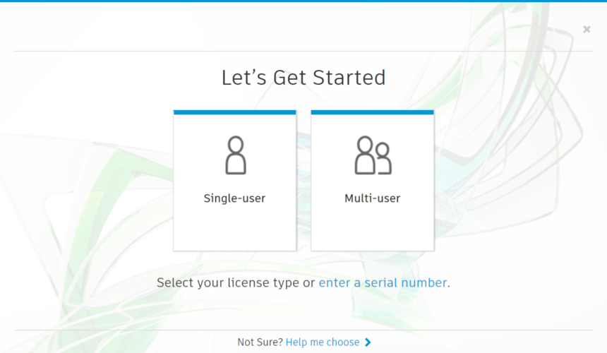

    1. For example, click File New. The Let's Get Started (LGS) window appears:
      Note: If the license prompt is not started, enter the Inventor Nastran environment.
    2. Depending on your license type, click either Single-user (for a standalone license) or Multi-user for a network license.
    3. If you have a network license, enter the port number and server name in the format <port>@<servername>. It might be necessary to use the server IP address instead of the server name. Using an IP address can resolve Domain Name Service (DNS) name resolution problems.
      Standalone licensing requires you to enter your Inventor Nastran Serial Number and Product Key.
  4. If you experience issues connecting to your server and obtaining a license, it might be necessary to add the System Environment Variable: FLEXLM_TIMEOUT, with the Variable Value set to 15000000. The timeout value is in microseconds, and this value represents a 1.5 second timeout interval. Over VPN connections and slow wide area networks, the default timeout (without the specified system variable) is often inadequate. If you still encounter difficulties, increase the timeout value further.
    Note: You can also set this variable as a User Environment Variable. The advantage of making it a System Variable is that it will be applied for any user that logs into the workstation. In a multi-user situation, you would have to define the User Variable in every user's profile.
  5. Log in using your Autodesk User ID account. If you do not have an account, you can create one here: https://accounts.autodesk.com/

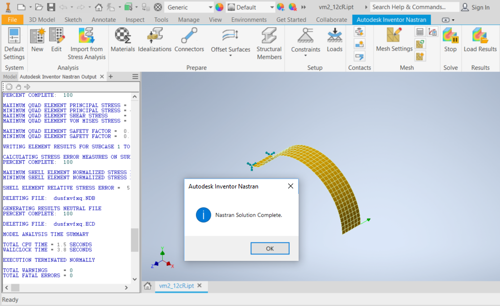

  1. Launch Autodesk Inventor from the Windows Start Menu or a desktop icon.
  2. Open the file, vm2_12cR.ipt, located in the C:\Users\Public\Public Documents\Autodesk\Inventor Nastran 2020 \Verification Models\en-us folder.
  3. Select the Environments tab, and click Autodesk Inventor Nastran.
  4. On the Autodesk Inventor Nastran ribbon bar, click the Run button to run the model. The Autodesk Inventor Nastran solver should terminate with no error or warning messages, as shown in the following picture:
    Note: Make sure everything works when you are logged in as an Administrator.
