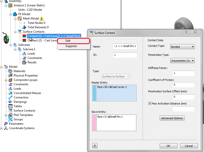

By default, all automatically-computed contact pairs are set to Bonded. This means that the two parts move together at the contacting surface due to forces acting on the model. To change the contact definition, right-click on the contact entry in the Tree, and click
Edit. You can then select the desired contact type from the list:

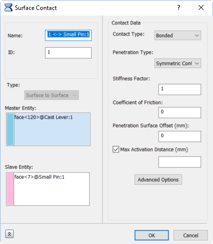

On the Surface Contact dialog, there are two options for defining contacts:
Auto
The
Auto option allows you to define multiple contacts automatically. You only need to define a single contact boundary for each contact pair.
Notes:
- The Tolerance and Max Activation Distance define the separation between two surfaces considered to possibly be in contact. The value is roughly the physical separation distance between the two entities.
- The Stiffness Factor is the stiffness of the contact joint. This value is based on the stiffer of the two joined sections. Use the default value if the two entities have similar stiffness values.

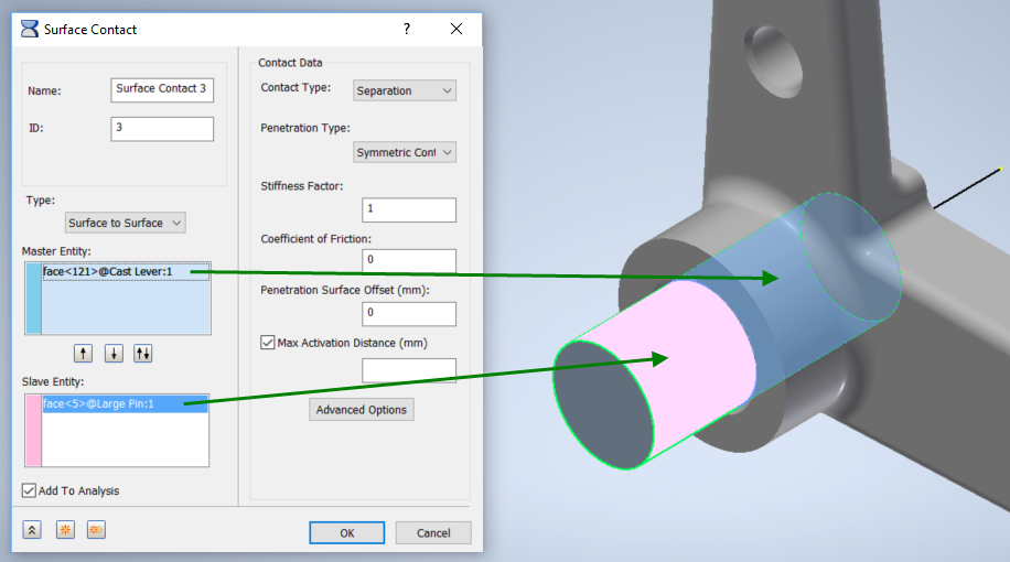

Manual
With the
Manual option, you specify the master and slave surfaces or edges involved in the contact.
The Master surface usually has the more coarse mesh. The Slave surface cannot penetrate the master. The use of a Symmetric
Penetration Type
eliminates the distinction.
Notes:
- The
Max Activation Distance should be slightly larger than the maximum expected sliding or motion.
- For similar surfaces, the default
Stiffness Factor is acceptable. Reduce the value if one body is much softer than the other. Increase the value if the contacting entities penetrate one another too much.
