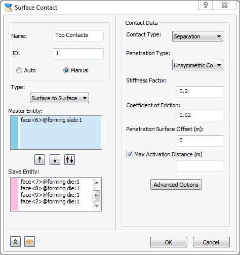

Create the Surface Contacts
  1. In the Model tree, right-click on Surface Contacts and choose New.
  2. Change the Name to Top Contacts.
  3. Click inside the Master Entity box, then pick the top surface of the sheet slab as the Master Entity surface.
  4. Click inside the Slave Entity box, then select the contacting face of the die, as shown in the image below.
  5. Make sure Add to Analysis is checked.
  6. Enter 0.2 for the Stiffness Factor, and 0.02 for the Coefficient of Friction.

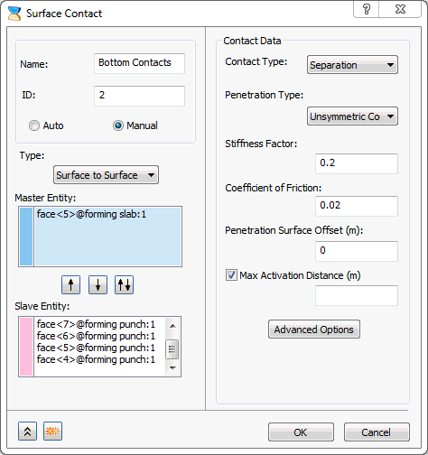

  7. Click on Duplicate button and change the Name to Bottom Contacts.
  8. Clear all the entities and re-select the Master Entity as the bottom surfaces of the sheet slab and Slave Entity all the contacting faces of punch model, as shown in the image below.
  9. Click OK to create the surface contacts.
