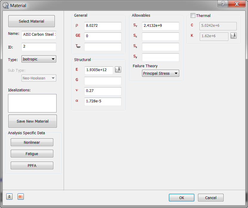

  1. In the Model tree, right-click on Materials and choose New.
  2. In the dialog, click on Select Material.
  3. The Material DB dialog will become populated with the available libraries. Click on Load Database.
  4. Browse to C:\Program Files\Autodesk\Inventor Nastran 2020\In-CAD\Materials, and open the ADSK_Materials.nasmat file.
  5. The material tree is populated with the available materials. Under the Steel category, select AISI Carbon Steel 304 and click OK.
  6. Click OK to close the Material dialog box.

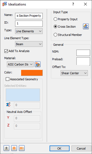

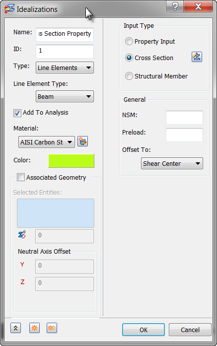

  7. In the Model tree, right-click on Idealizations and choose New.
  8. Select Line Elements from the Type drop-down menu.
  9. Rename the property to Beam Cross Section Property.
  10. Select Beam from the Line Element Type drop-down menu.
  11. Select Add to Analysis and ensure that Material is set to AISI Carbon Steel 304.

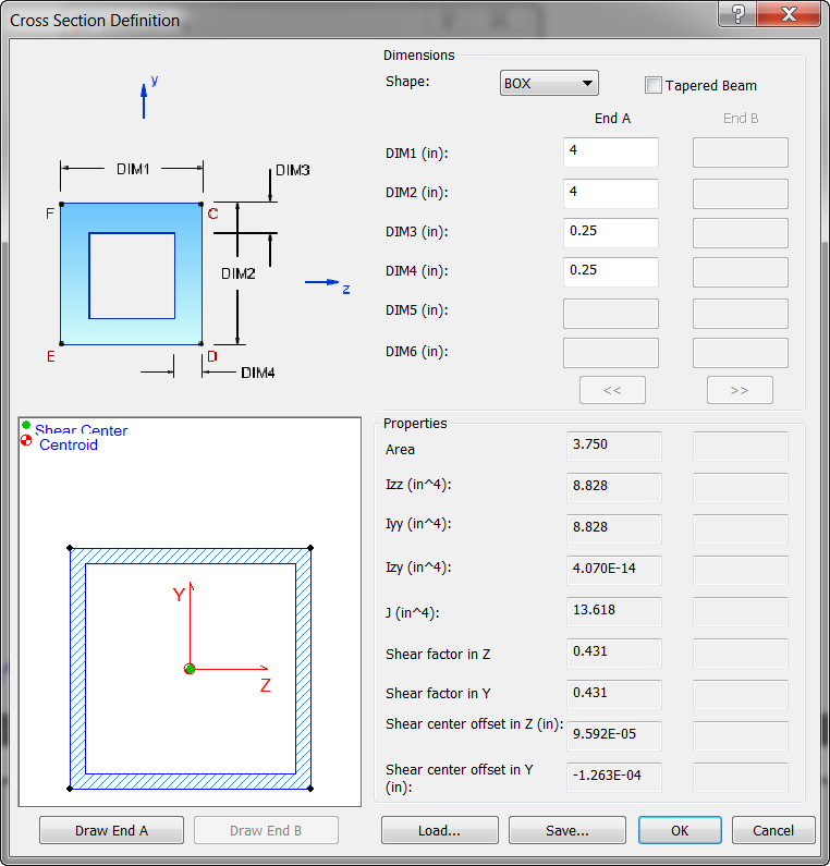

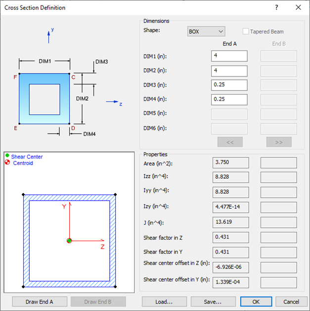

  12. Select Cross Section in the Input Type group box and click the Define button.
  13. Select BOX for the shape, and define the dimensions as shown in the image below. Click the Draw End A button to view the properties.
  14. Click OK.
  15. Make sure Associated Geometry is unchecked.
    This will create a mesh with the cross sectional properties for each one of the sketch segments in the model.
  16. Click OK to create the Idealization.

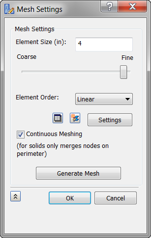

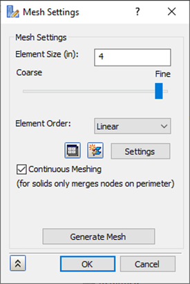

  17. Right-click on Mesh Model and choose Edit.
  18. Enter 4 for the Element Size and change the Element Order to Linear.
  19. Click Generate Mesh to mesh the geometry and then click OK.
