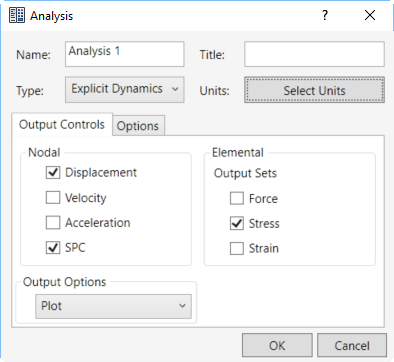

  5. Right-click Analysis 1 > Edit, and then in the Analysis dialog, set Type to Explicit Dynamics.
    Ensure that Displacement and SPC boxes are checked.
  6. Also in this dialog, click Select Units and ensure that the Unit System is either CAD Model or English, using inches, pound force, and seconds.
