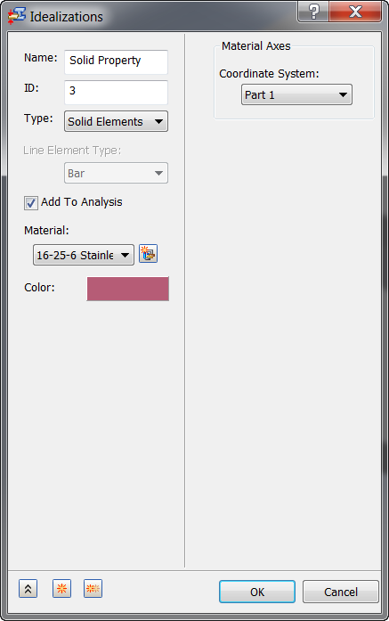

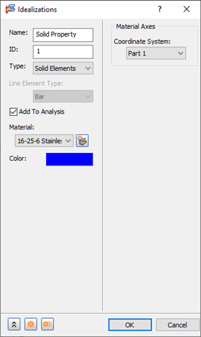

  12. In the Model tree, under Idealizations, right-click Solids and select New.
  13. In the Idealizations dialog, type Solid Property for Name, select Solid Elements under Type, and ensure that Material is set to 16-25-6 Stainless Steel.
  14. Then click OK. Solid Property is added to the Idealizations list.

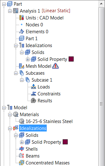

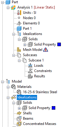

    The tree view should now look as shown below.

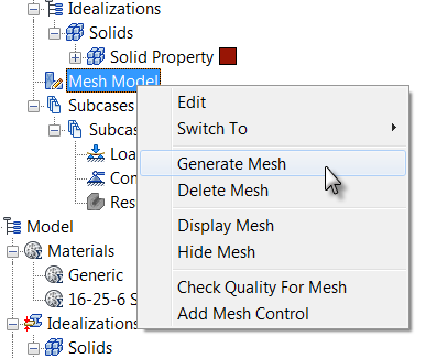

  15. Right-click on Mesh Model and select Generate Mesh. This will generate a solid mesh with parabolic tetrahedron elements and a default size based on the object dimensions.
    The meshed model should look as shown below. (If you cannot see the mesh, right-click anywhere in the tree window and select Default Settings. Go to Display Options, and select the checkbox next to Mesh Model.)
