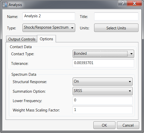

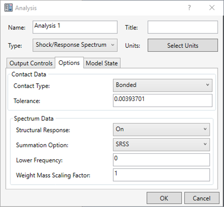

. Set the Analysis
Type
to
Shock/Response Spectrum
On the
Output Controls
tab, select
Displacement
Velocity
Acceleration
, and
Stress
Note that the
Options
tab has a
Spectrum Data
section with options specific to this analysis type. Set these options as shown below:
