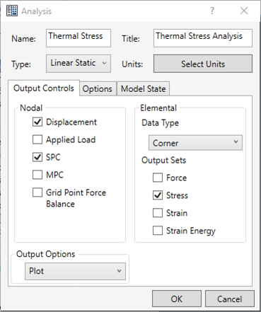

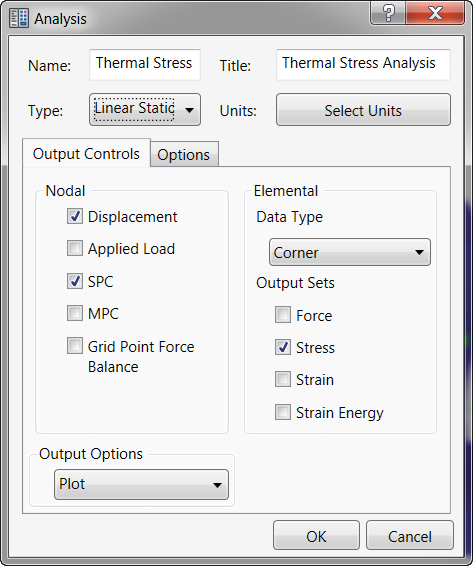

- Enter
Thermal Stress
for
Name, and type
Thermal Stress Analysis
for
Title. Change the analysis
Type to
Linear Static from the drop-down menu.
- Click
OK.

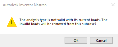

- All thermal loads will be removed from the analysis as they are not related to the linear static analysis. However, the
Initial Temperature had to be removed manually.
- Click
OK in the following message window.

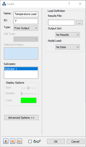

- Right-click on
Loads under
Subcase 2 and select
New.

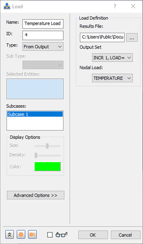

- Change the
Name to
Temperature Load.
- Change the
Type to
From Output.
- In the
Load Definition section click on the browse button for the
Results File. Navigate to the location of the FNO file, which was generated after running the Nonlinear Steady State Heat Transfer Analysis. For example,
C:\Users\Public\Public Documents\Autodesk\Inventor Nastran 2020\Tutorial\en-us\Inventor 2020\Thermal Stress Manifold\In-CAD\FEA folder. Then open the FNO file.
- The
Load dialog shows that
INCR 1, LOAD=1.0 is selected as the
Output Set and
TEMPERATURE is selected for the
Nodal Load, as shown below.
- Click
OK to complete the definition of temperature load from output.

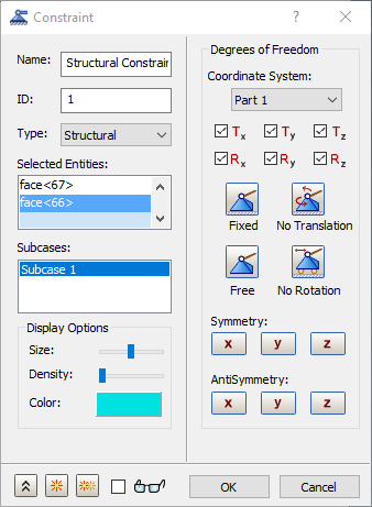

- In the tree view, right-click on
Constraints and select
New.

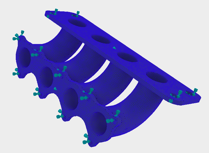

- Select the bolt hole surfaces highlighted in blue in the image shown below.
- Rename the constraint to
Structural Constraints.
- Accept the default settings. Be sure that
Subcase 2 is highlighted, and then click
New button to define another constraint.
- Rename
Constraint 2 as
Sliding Surfaces. Select the surface on both of the flanges facing away from the tubes highlighted in blue in the image shown below.
- Uncheck all the degrees of freedom except
Tx. This will allow the nodes on the surface to slide about the plane they are in, but will not allow it to penetrate it.
- Make sure that
OK to close the dialog.
- The final model should look as shown below.
- After defining all entities, the final tree view should look as shown below.

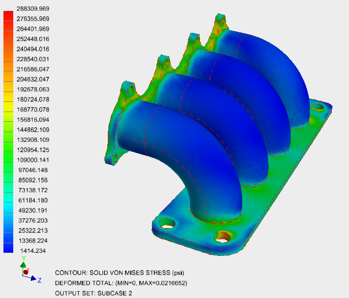

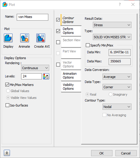

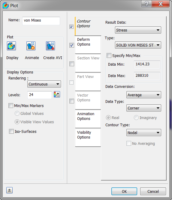

- Under
Results in the tree view, right-click on
von Mises and select
Edit.
- Uncheck
Max/Min Markers under
Display Options. On the
Deform Options tab, select
Actual to view the actual displacements. On the
Contour Options tab, ensure that
Result Data is set to
Stress, and Type is
SOLID VON MISES STRESS. On the
Visibility Options tab, select
Hide All.

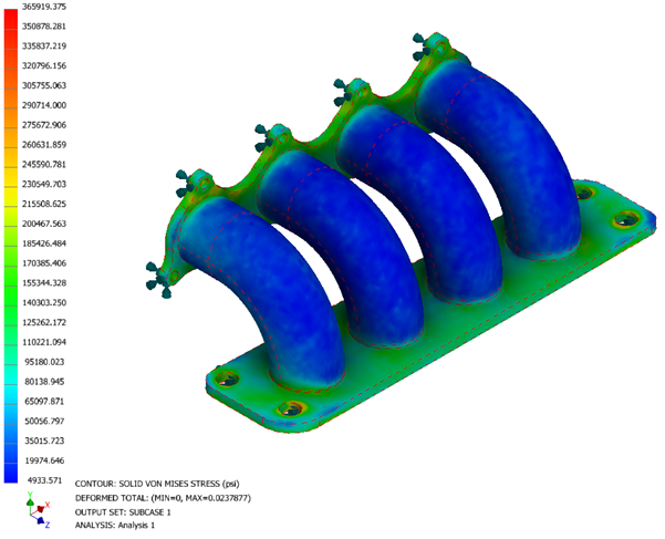

- Click on
Display. The results should look as shown below.
