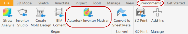

  4. Click Environments > Autodesk Inventor Nastran.
