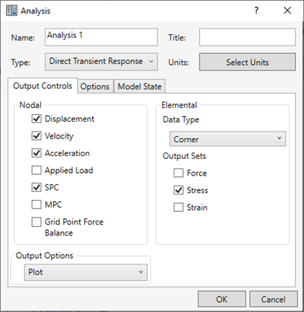

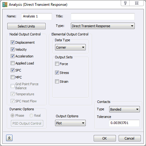

Tutorial A2: Define the Analysis, Properties, and Mesh
  1. In the tree view, right-click on Analysis 1 and select Edit.
  2. Select Direct Transient Response from the Type drop-down menu.
  3. Check the Velocity and Acceleration checkboxes.
  4. Click OK.

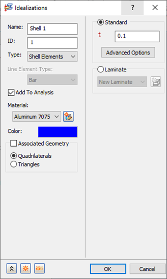

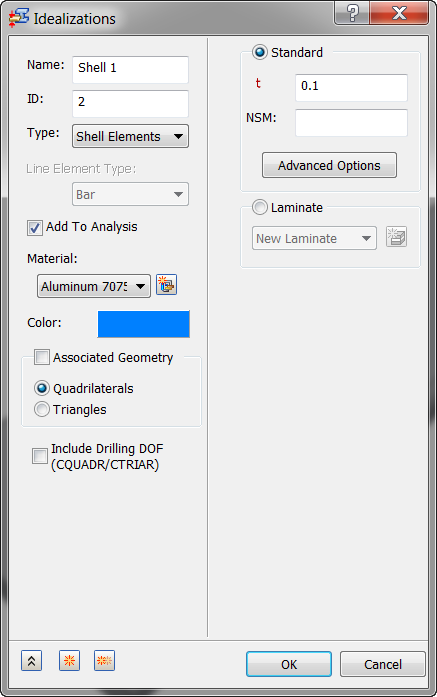

Define Element Properties
  1. In the Model tree, under Idealizations, check for any existing definitions under the standard categories, such as Solids and Shells. Solid 1, shown below, is an example of an existing definition:
    If there are any existing definitions, right-click Idealizations > Delete All. Doing this ensures that you won't have unwanted materials appearing in the part mesh and participating in the analysis.
  2. In the Model tree, right-click Idealizations > New.
  3. Select Shell Elements from the Type drop-down menu.
  4. Ensure that Material is set to Aluminum 7075 Heat Treated (T6) Wrought.
  5. Enter 0.1 in the t (thickness) field.
  6. Click OK.

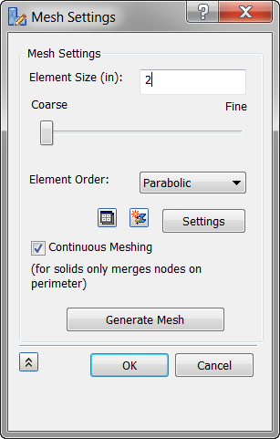

Define the Mesh
  1. Right-click Mesh Model > Edit.
  2. Type 2.0 in the Element Size field.
  3. Click OK to generate the mesh. The mesh should look as shown below.
Typically, it is wise to define a material orientation for shell element models. However, this is not done in this case.
