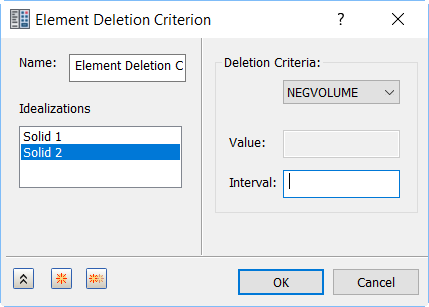

For Explicit Dynamics or Quasi-Static analysis, specify elements to be deleted from the mesh, using Deletion Criteria.
In the Part tree, right-click the Idealizations node to select Add Element Deletion. The contact logic in Autodesk Explicit can automatically rebuild the surfaces of the model as elements are deleted or eroded from the contact surface. This allows users to model the penetration of one part into another.
Specify the Deletion Criteria on a selected physical property, as follows:
In the Idealizations field, select the elements to which the criteria will be applied.
