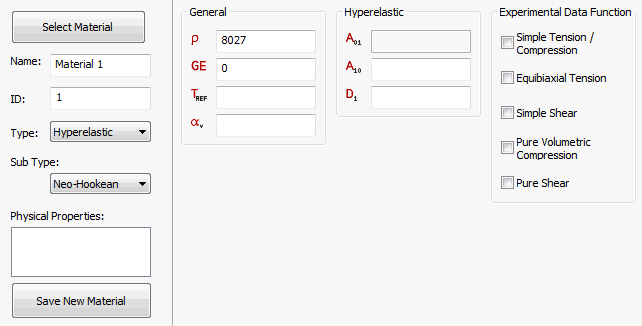

After selecting Hyperelastic from the Type drop-down, the following material sections will become available: Hyperelastic and Experimental Data Function.
: Allows you to define an experimental data function obtained from physical tests. You can define tables for
Simple Tension/Compression,
Equibiaxial Tension,
Simple Shear,
Pure Shear, and
Pure Volumetric Compression.
